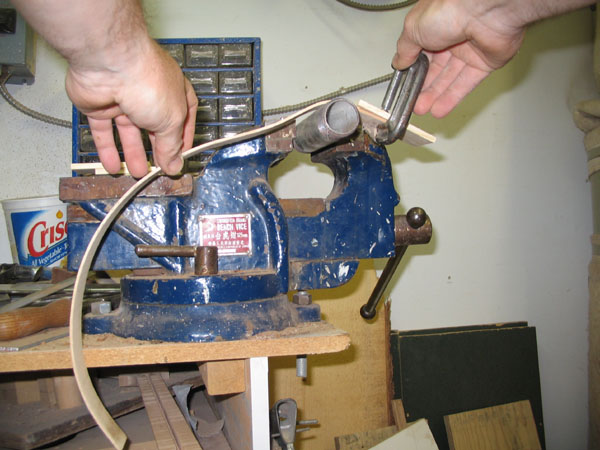

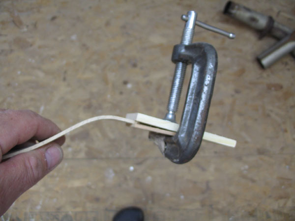

A while back, we talked of bending the short pieces of a cutaway, and I mentioned that we can use a couple pieces of wood and a clamp to help out if the peice is really short. Someone asked for photos, but I didn't have time right away...
Here's what I was talking of. Just two little pieces of scrap, with the bottom one being as thin as possible(to not get in the way of the bending).
Mario38937.9635648148

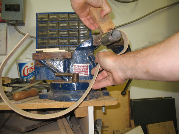

And finally, if we need to bend right up to the edge of the work, we can use a block to hold the rib to the pipe, while the other hand pulls the rib down to set the bend.
I always try to use a longer rib than needed, and trim afterward, but sometimes the figure is best right at the edge, or the piece snapped once and is now just barely long enough, or whatever. I've used this method more often than the clamp, but both work well.
